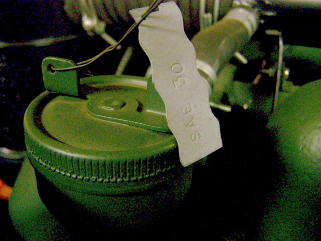

Notapor m606paz » 13 Mar 2014, 23:26
charlie s. escribió:Ya que el sistema para poner fotos funciona, quería preguntar si alguien sabe para que es el agujerito que tiene una de la orejas de la tapa/medidor
de aceite en los motores Go -Devil
Sls
HK G36 escribió:What is The small hole on the top of this oil filler cap for, is it for a securing wire?
Quartermaster escribió:Mine has a wire loop through it - also on the wire loop is a metal tag 3/4" X 3" and stamped "SAE 30" The long sides of the tag are cut in a wavy pattern. You can find the same tag pictured in All American Wonder Volume 2, page 227.
Obviously, originally placed there to prevent some Sad Sack from putting the wrong weight and/or type of lubricant in the jeep when it was being serviced.
Mark Tombleson escribió:I can't tell you where I got it from as I don't remember... but I think someone gave it to me as a gift. :?
Mas discuciones en http://g503.com/forums/viewtopic.php?f=4&t=75223

Notapor tito canale » 14 Mar 2014, 15:23
La mas lógica en la Argentina es para poner una cadenita para que no te afanen la varilla :roll: :roll: :evil:

Notapor charlie s. » 14 Mar 2014, 16:30
Tito,
entiendo a lo que te referís, pero la tapa y la varilla de controlar el aceite, mide aprox 85 cm.
Te imaginás el largo de la cadenita ? :wink:

Notapor m606paz » 14 Mar 2014, 16:36
No es un poco liviano el aceite que indica Data tag? :roll:
Es es para los motores recien armados..... :roll:
