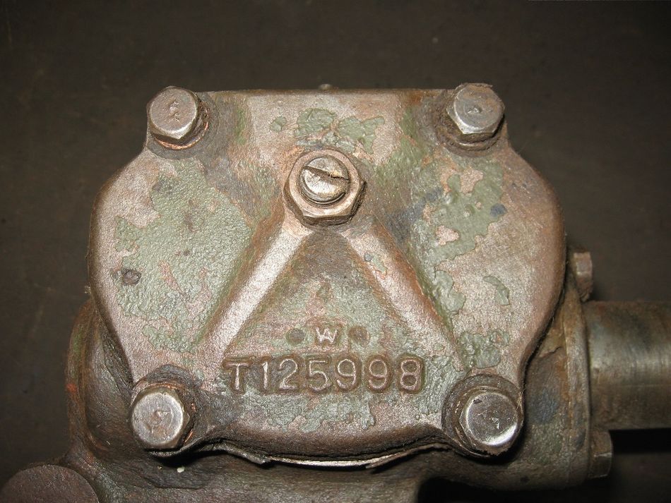

mm creo que la que tengo yo del MB es de Cj :? estoy bajando las fotos pero les adelanto las marcas que tiene:
ROSS
PATENTED T1 25983 CREO QUE DICE
EN LA TAPA DE LA CAJA ( LA CHIQUITA) TIENE LA MARCA T125998
TIENE OTRAS MARCAS QUE NO SE NOTAN MUCHO
Notapor vladimirsinisi » 30 Mar 2012, 13:09
Bueno pongo fotos ustedes diran :?

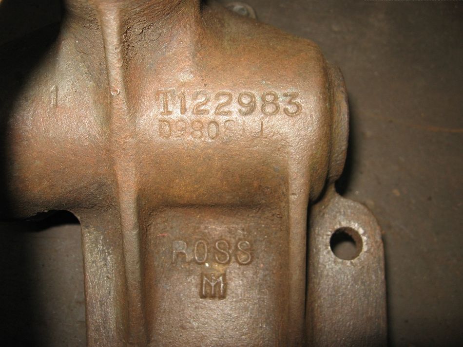

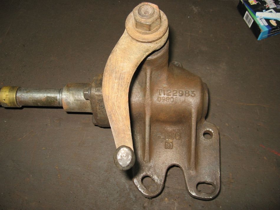

Notapor m606paz » 31 Mar 2012, 22:04
m606paz escribió:ROSS #2
Features: has web, but no collar and no buttress. Tower is thicker than ROSS#1
"ROSS", and either "U" or omega in box, OR "modified M" ebossed on mount plate (right side up)
"T122983" stamped on tunnel right side up
Internal difference: On some of these that I've opened up, there is a tube from the housing lower end plug on the bottom of the tunnel that goes up through the center of the worm gear.
this part is not listed in any TM I have found.
this part IS listed in CJ manuals. CJ-2A's before serial number 178361 used the same horn brush and contact ring as the MB's and GPW's. after CJ-2A 178361, the horn wire continued down through the worm gear, and through this tube.
Before you start thinking this gear was only used on later CJ's, take a look at TM 9-803 figure 99 "Steering Gear, Disassembled". page 213 in my copy ( I wish my scanner was working). This picture shows a housing without buttress and collar, and with a thick tower. Most drawings in the TM's show ROSS#1 above.
My opinion:
Ford GPW's used a Ford GPW steering gear. (duh) The jury is still out on whether there is more than one model.
Willys MA's and early model MB's used the same ROSS housing. The MA used a different complete assembly because of the gear shift on the column. This housing would be the ROSS#1 above.
Sometime before the end of production, the ROSS#2 might have been used. I originally thought the ROSS#2 was only used on CJ's but there seems to evidence it was used on MB's.
During the production of the CJ-2A the horn wire was redesigned and a tube was added internally.
I now believe ROSS#1 was used on all slat grills and most of the rest of the MB production.
I still have no idea what "early ross gear less strengthening ribs" means. And I have no clue when the change from ROSS#1 to ROSS#2 might have occurred.
Feel free to email me with any information you might have!
Chris Fourroux
chris@opie.com
P.S.
And then there are the covers! There seem to be at least a dozen variations of these. Maybe that will be a topic for another web page in the future.
Lo que esta en negrita, traducido seria esto
En algún momento antes del final de la producción, la ROSS # 2 podría haber sido utilizado. Al principio pensé Ross # 2 se utilizó sólo en CJ, pero parece que hay pruebas de que se utilizó en la MB.
Aqui estan las fotos de la caja de direccion que estaba montada en el MB.
Coincide con los descripto antes por Chris Fourroux :shock:
Mi jeep seria DOD Marzo de 1945... tal vez corresponda, no?? :roll:
Notapor charlie s. » 31 Mar 2012, 22:39
Hola Mariano,
esa caja de direccion todavia parece tener pintura O.D. (o es la foto que enga#a ?)
Para estar bien seguro, habria que checar si los ultimos MB traian entre sus bulones los marcados con AA que son los 4 que tiene tu caja de direccion.
