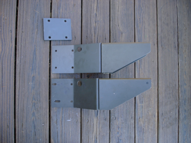

Parece ser que hubo un soporte de MP-50 desarrollado para instalar en los jeeps M38A1 para que quede dezplazado de la linea de la carroceria,igual que su antecesor el M38.
Este es el soporte que todos conocemos
Y este el desarrollado para el M38A1

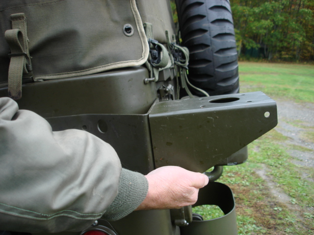

Ben Dover escribió:
This is the later version of the SC-C-28591 Bracket, note that it extends across the joint of the M-38A1 rear body side and the rear body panel and alligns with the Trailer Receptacle Grounding Screw.
NOTE the Guide A2 Reflector with Guidex Lens and proper screw used fto attach the reflector to the Jeep. :wink:

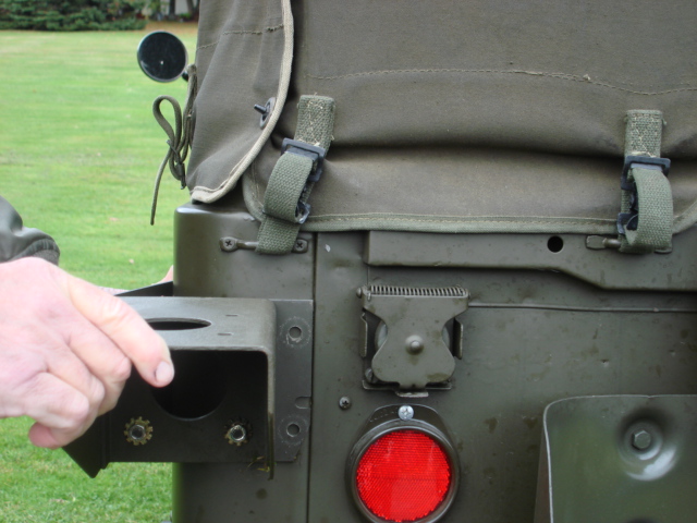

Ben Dover escribió:Late bracket.
Note the NOS Goodyear 700X16 NDCC. :wink:
Aqui las comparaciones entre ambos

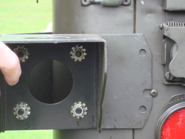

Ben Dover escribió:
Do not forget to use the correct toothed washers (Int/External Tooth) :wink:
Most of the present M-38A1 Collectors are unaware of the upper bracket which is designed for the wider body of the M-38A1

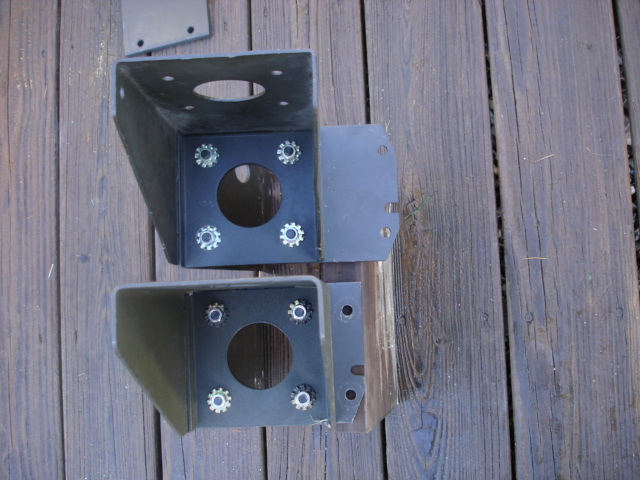

Ben Dover escribió:Upper bracket is the earlier SC-C-28591
Note the mounting holes on the late bracket on the bottom.
Tom Wolboldt escribió:Yes!
Also the right side rear mounting holes barely pass to the right of the body seam and the slot does not come close to indexing the single screw head on a M38A1.
I also have a third style bracket, not shown in the above photos, that mounts up against the trailer socket and perfectly indexes the single screw head on a M38A1
